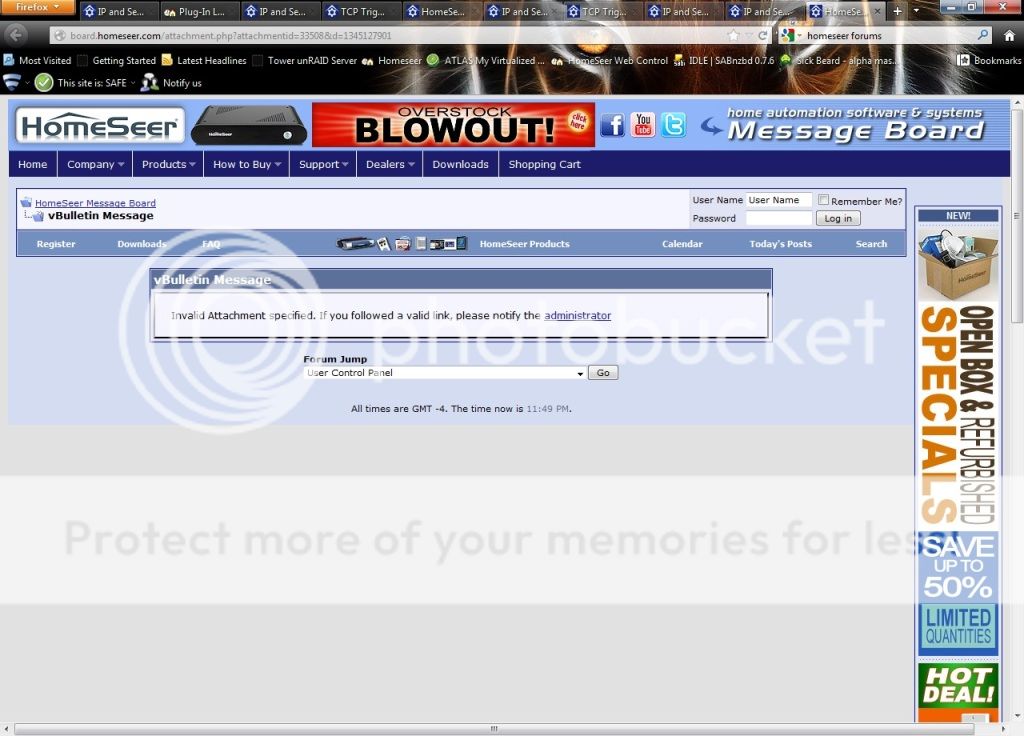

    This is what I see when I attempt to download the plugin. thanks for the reply. Do you mind sharing you irule setup, like components anything special you are doing etc. I have a Onkyo txsr800 series(controlled by an Itach IP2SL with feedback), Popcorn Hour A300 (controlled by TCP/IP), Panasonic AE4000-u (IP2SL). i can only control by lights by the status page in homeseer. I started out thinking I could setup HStouch to be primary interface but I am game to anything, as long as I can get it to work reliably.
    Comment
    • #17
      I've the same problem. Just found your plugin want to download it but the same error as above.
      Comment
      • #18
        Not sure what happened there but fixed now. The download is working again. Just about to run to the airport for a flight, I will share some of my iRule setup later.
