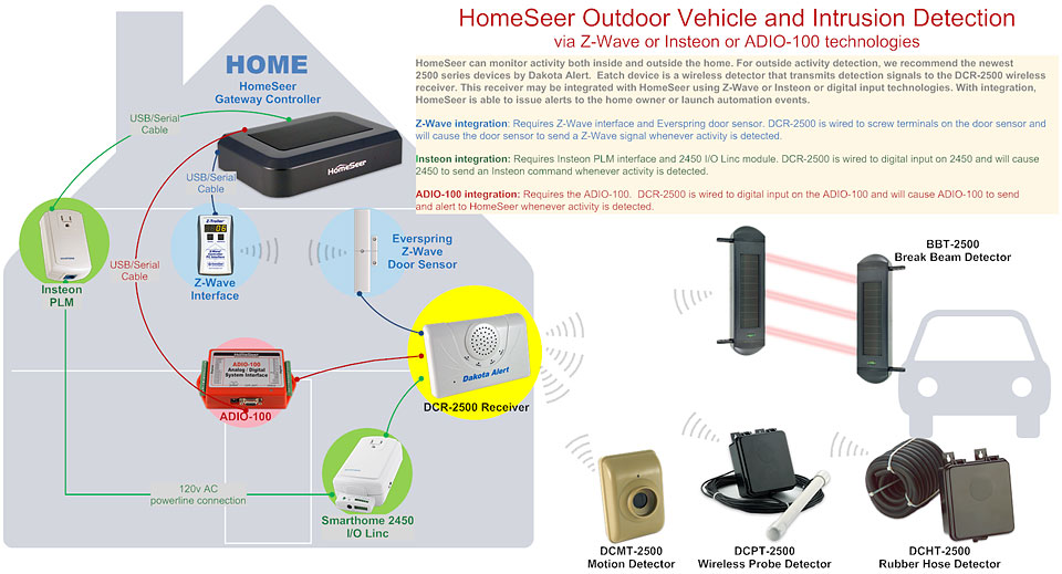

HomeSeer can monitor activity both inside and outside the home. For outside activity detection, we recommend the newest 2500 series devices by Dakota Alert. Each device is a wireless detector that transmits detection signals to the DCR-2500 wireless receiver. This receiver may be integrated with HomeSeer using Z-Wave or Insteon or digital input technologies. With integration, HomeSeer is able to issue alerts to the home owner or launch automation events.
Z-Wave integration: Requires Z-Wave interface and Everspring door sensor. DCR-2500 is wired to screw terminals on the door sensor and will cause the door sensor to send a Z-Wave signal whenever activity is detected.
Insteon integration: Requires Insteon PLM interface and 2450 I/O Linc module. DCR-2500 is wired to digital input on 2450 and will cause the 2450 to send an Insteon command whenever activity is detected.
ADIO-100 integration: Requires the ADIO-100. DCR-2500 is wired to digital input on the ADIO-100 and will cause ADIO-100 to send and alert to HomeSeer whenever activity is detected.
