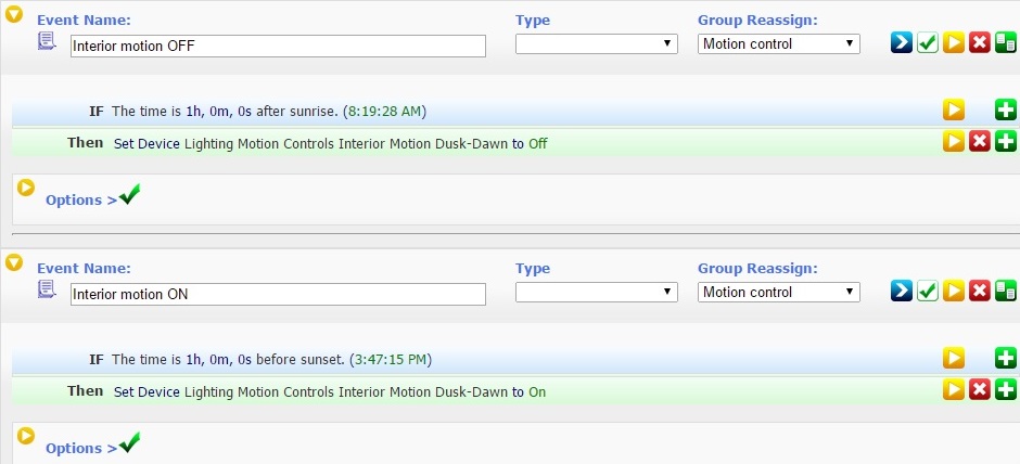

    First we need to create two virtual devices. The first "Motion Control Dusk-Dawn", is a control to allow the motion control of lighting to be limited to times when there is actual need for additional light in the rooms. There is a condition of "Nighttime" which is valid from Sunset to Sunrise, but in actual use, there is a period before sunset and after sunrise where there is not enough ambient light to filter in to interior rooms. So we want to enable motion control 30-60 minutes before sunset and keep it enabled 30-60 minutes after sunrise. There are no event conditions that will handle this. Here is a list of all of the time conditions available:
    What is missing is "The time is after this before sunset" where you could plug in your 30-60 minute dusk "buffer" in the condition. Similarly there is no condition "the time is before this after sunrise". The absence of these two conditions make a virtual device the easiest way to implement the Dusk-Dawn timing. Once created and controlled, this one virtual device can be used in many events.
    The second virtual device we need is used to disable motion control for a lighting group. One of these devices needs to be created for each lighting zone that uses a single motion detector. In this case the lighting group is in an exercise room, so we'll name its control "Exercise Motion Control".

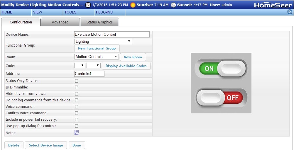

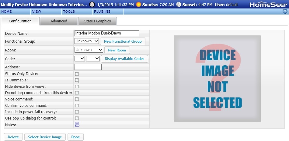

    Here are the step by step instructions for creating a virtual device. At the top right of the device manager page are a series of icons. As in the Event Management page the "+" symbol indicates adding a new device.
    You are prompted to name the device.
    I named the first of mine Interior Motion Dusk-Dawn.
    Click on Submit and you will have a normal looking single device configuration page where you can give "Floor and "Room" assignments to the device.

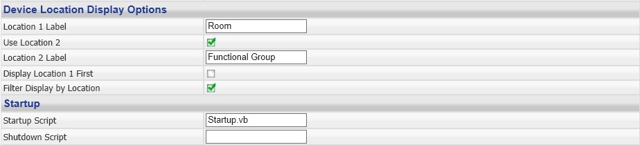

    In my installation I chose to use "Functional Group" and "Room" for my Label 2 and Label 1 respectively. In some of the following screenshots you will see that new label.
    You can change those labels in HomeSeer Setup under the Custom tab.
    I assigned a Functional Group "Lighting" and a Room "Motion Controls". You can chose your own naming conventions and labels to suit your own organizational requirements. I have made my decisions on how I want to be able to filter devices within the Device Manager as well as how they are represented in the HSTouch Default Projects. You can change the labels at any time and you can reorganize your devices within those labels individually or as groups of devices.
    Then create the second device which is used to enable or disable motion control on an individual light. That device is created in the same way as the first device. Then you will see your two new devices in your Device Manager, here filtered on Motion Controls. If you notice, your virtual devices look like any other physical device, with ON-OFF controls, status text and status graphics.

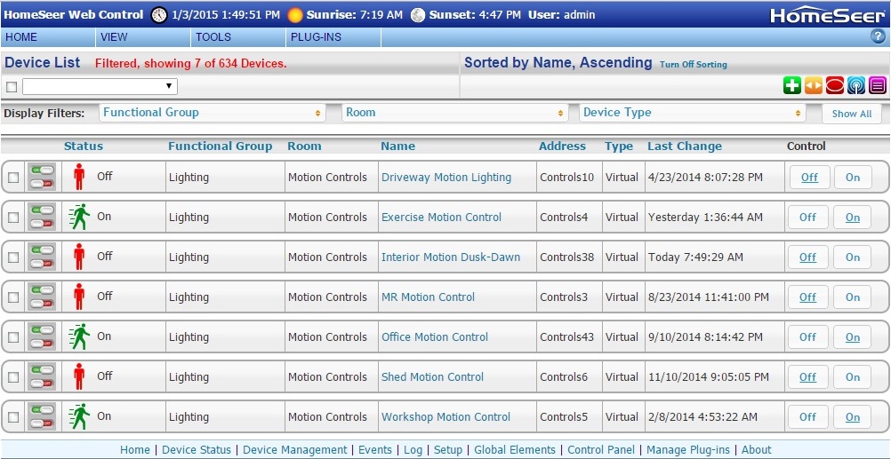

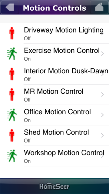

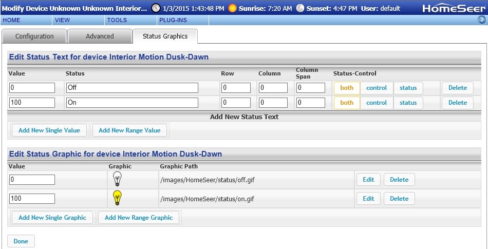

    In many cases the standard Status Graphics of a virtual device can be improved upon to more accurately show their function. A light bulb really doesnt give a good representation of a control device. Here is a screenshot of a production system, filtered on motion controls. There is a virtual device to disable controls on all 6 of my motion controlled lights. You will notice in the screenshot, there are different Device Status graphics as well as a custom device image assigned to each of the virtual devices. This really helps identify the device type and status when looking at the Device Manager web page as well as with the HSTouch default project pictured below.
    Virtual devices do not have a default device image. The device image is added on the Configuration tab. Use the select Device Image button and you can browse to images to select. The default location for device images is under your HomeSeer root directory then html\images\Devices. You can use one you find there or capture your own and store it in a folder under your HomeSeer installation. It would be good practice to create your own directory for any custom device images you use such as html\images\CustomDevices. The Device Image used in this example was grabbed through a Google Images search.
    You can change the status graphics on the corresponding tab. You can also change the text to be "Enabled" and "Disabled" or anything else instead of the standard "On" and "Off" text. The default location for Status Graphics images is under your HomeSeer root directory then html\images\HomeSeer\status. You can use one of the images HomeSeer provides with the installation or you can capture your own and put them in a folder under the HomeSeer installation. Again it would be good practice to create your own directory for any custom status images you use such as html\images\HomeSeer\CustomStatus. This will segregate your custom images from the default images provided by HomeSeer. The Status Graphics used for these virtual devices were already provided with the HomeSeer installation.
    Before
    After replacing the light bulb Status Graphics images with motion graphics that were provided with the HomeSeer installation.
    The below screenshot shows what the custom Status Image graphics and group organization provides with the default project in HSTouch.
    The Dusk-Dawn virtual device is controlled by two events. The purpose of the control is to enable motion control of lights before sunset as it begins to get dark and to keep them enabled after sunset until the ambient light from the windows is enough to negate the need for additional lights. The events below enable that device 1 hour before sunset and disable it 1 hour after sunrise. You can change the timing to what works best for you. Our Motion controlled lights are in the basement and in outbuildings with small windows. I use this device as a condition in all of my Motion Control ON events for lighting.

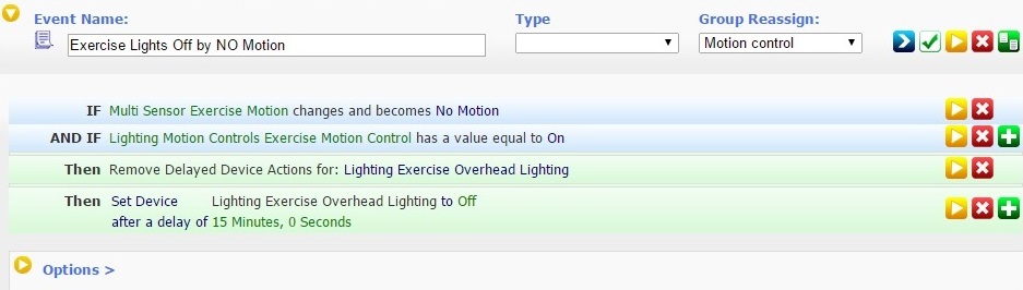

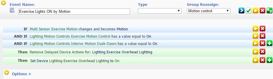

      Lets build the Lights ON by Motion Control event. It is a straight forward event if the motion detector in that room goes to Motion, the event is triggered. Then we add two conditions, the first checks to see if motion control is enabled for that zone and the second checks to make sure it is within the Dusk-Dawn time constraints created above. Both of those conditions just look at the virtual devices and makes sure they are both ON.
      The first action is to Remove Delayed Device Actions for this lighting zone. Our off event will be creating a Delayed Device Action to turn the lights off, so this action will remove any of those that might have been created by recent entries and exits into this control zone where manual control of the lights might be used and will assure that the lights are not turned off while the room is occupied. We'll discuss the Delayed Device action further in the next event. The second action turns the lights on.
      The next is another straightforward event to turn the lights off after the room is no longer occupied after a 15 minute delay. You can adjust that delay to suit your needs, 5 minutes is probably adequate, but we like to use 15. This event is triggered when the zones motion detector changes to No Motion. There is one condition in this event where it looks at the Motion Control virtual device for this zone to make sure it is enabled. Again in this device the first action is to Remove Delayed Device Actions for this lighting zone. This assures us that the 15 minute delay is reset when the motion detector goes to no motion. It is redundant to the same action in the ON event and the ON event should have removed any Delayed Device Actions, but it doesnt hurt to check again. The second action is what creates a new Delayed Device Action to turn the lights off after 15 minutes. When you put a delay on an action in HomeSeer, the event completes and creates a single event that is triggered to run exactly at the time dictated in the delay. This new Delayed Device Action event is designed to remove itself after running. It is also placed in a dynamically created event group for Delayed Actions. The first action above to Remove Delayed Device Actions will look in that folder and delete any events referencing the referenced device.

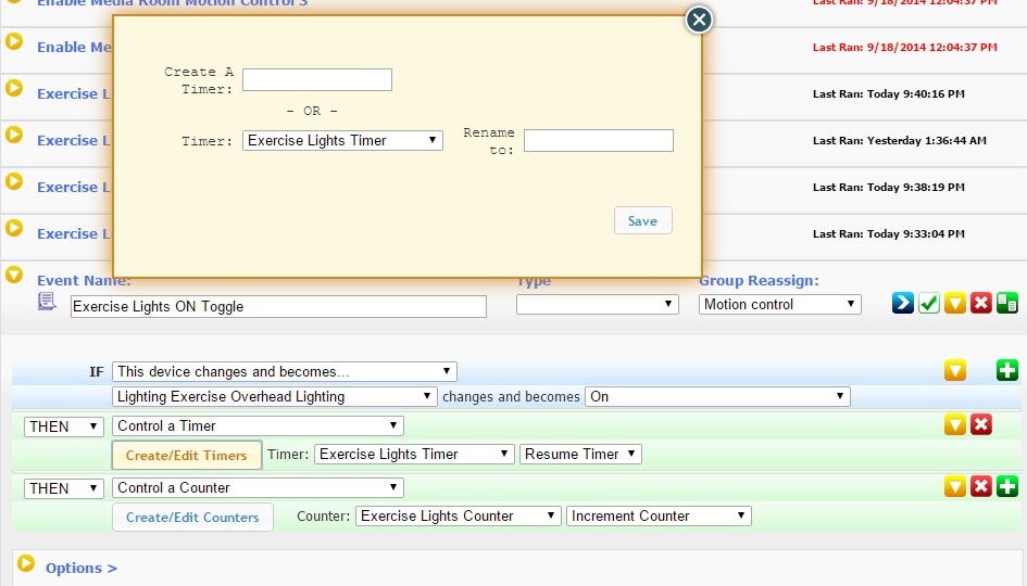

      Well use the event to create the timer. If you notice on the expanded event there are buttons to Create/Edit Timers.
      If you click on the button you will be presented with a popup allowing you to choose an existing timer, rename an existing timer or to create a new one. We created a new timer Exercise Lights Timer
      Likewise we create a counter named Exercise Lights Counter

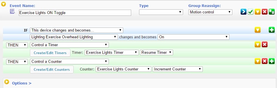

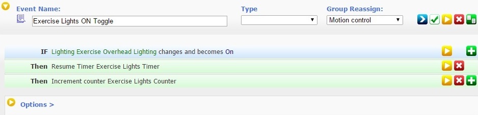

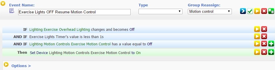

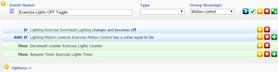

      Finally we have an event that is triggered each time the lights in that zone are turned on. When it is triggered we Resume the timer and increment the counter. This event allows to count the number of times the switch is turned on and makes sure the timer is running.
      A similar event is used for the light switch being turned off, but a condition is added to make sure motion control is enabled for this zone before it is allowed to resume the timer and increment the counter. It is the same counter as above, we are only counting switch changes, we dont care whether it is off or on.

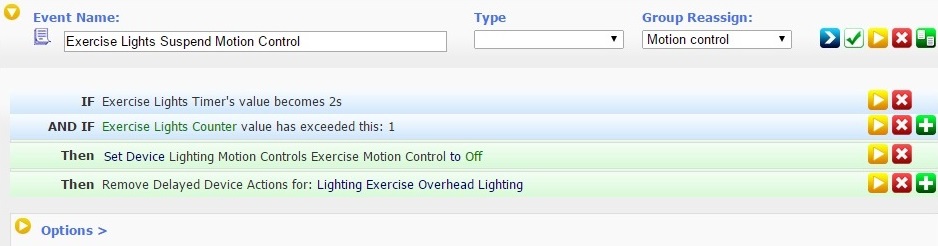

      Now we build an event to utilize the timer and counter to let the system decide what to do. The trigger is when the timer reaches 2 seconds. It looks at the counter to make sure it is more than 1. If the counter is higher than 1, meaning the switch has changed at least twice within a 2 second period. If it is triggered and the condition is met, it turns Motion Control for this zone off and it removes Delayed Device Actions for the lights. If we have turned the lights ON-OFF-ON within 2 seconds, the Motion Control is disabled and any Delayed Device Actions are removed. The result is that the lights are on and will stay on, regardless of motion or lack thereof. . If we turn the lights ON-OFF within 2 seconds, the Motion Control is disabled, with the lights off.

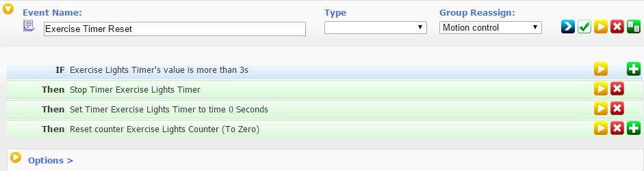

      Now we need to reset the timer and counter to get them ready for the next time. Regardless of whether the light is turned off or on or how many times, we want to stop the timer and reset it if it passes 2 seconds. We also want to reset the counter.
      The final event will restore Motion Control of the lights. It is triggered by the lights being turned off. The first condition checks to make sure the timer is not running. The second checks to see if the Motion Control virtual device is off. If both of the conditions are true, we know that the motion control has been disabled and that we are not in a counting cycle on the switch. The event will enable Motion Controls for the lights again if you turn them off as you leave the room.
