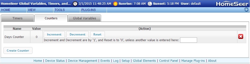

    Counters and Timers can be created in advance under the Tools> Global Variables, Timers & Counters tab at the top of the HomeSeer Web Interface. You can use the screen to create or manipulate Counters

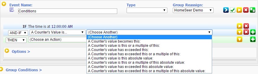

    There are quite a number of value checks for creating a condition based upon a counter, some of them are straight forward, some are so nuanced as to be unclear what their use would be and one is not clearly worded. Here is a screenshot of all of the choices.
    Let's just go through them and consider what they mean. Remembering that these are conditions, the wording on some of the choices are strange. Nevertheless, you can properly condition an event on the value of a counter
    1. A Counter's value becomes this: - This reads more like a trigger than a condition. In fact this is just poor wording, it would more correctly worded "A Counter's value is this:". Testing proves that this condition is true when the counter matches the value.
    2. A Counter's value is this or a multiple of this: - makes perfect sense. If you chose a value of 3, the condition would be true of the counter was 3, 6, 9, 12, etc.
    3. A Counter's value has exceeded this: - again straight forward, if you set the value as 3 it will be true when the counter is 4 or above.
    4. A Counter's value has exceeded this or a multiple of this: - this one is a little redundant. If you set the value to be 3 (or any number) once it has "exceeded this" the condition would be true. "a multiple of this" would ALWAYS "exceed this".
    5. A Counters value is this absolute value: - another one that is fairly clear, if you set the value to 3 it would be true if the counter's value is also 3. Since counters can be decremented to a negative number, it would also be true if the counter's value was -3. Absolute value can best be described as "distance from 0", so a negative value is treated as the same positive value.
    6. A counter is this or a multiple of this absolute value: The same as number 2 above, except the value is evaluated as as its absolute value regardless of whether it is positive or negative.
    7. A Counter's value has exceeded this absolute value: - the same as number 3 above, except the value is evaluated as as its absolute value regardless of whether it is positive or negative. if you set the value as 3 it will be true when the counter is greater than 3 or less than -3.
    8. A Counter's value has exceeded this or a multiple of this absolute value: - like number 4 above this one is also redundant. If you set the value to be 3 (or any number) once it has "exceeded this" the condition would be true. "a multiple of this" would ALWAYS "exceed this". The difference from number 4 is that the value is evaluated as absolute.
    I'm not sure when having an absolute value as a condition would see real world usage, but it is there if you need it.

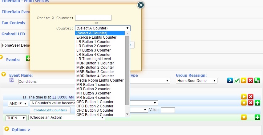

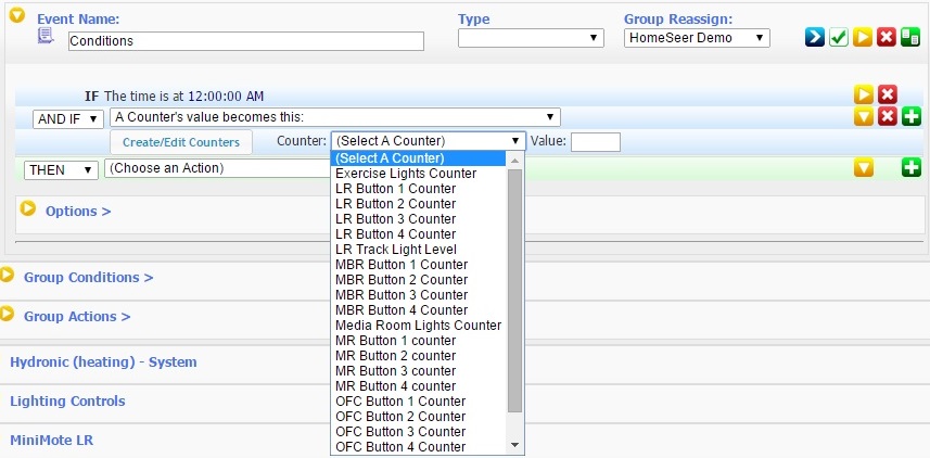

    After you have selected the condition, the window will be populated with a new line where you can choose among counters you have already created.
    Or you can click on "Create/Edit Counters and you will be presented with a dialogue box allowing you to create a new Counter or to choose an existing counter. If you try to create a counter with the same name as an existing counter, you will be notified that it exists and you can choose a new name. Be very careful cutting from another document and pasting into this name. If you paste a character that does not belong to the basic ASCII character set, you can corrupt the counter database.

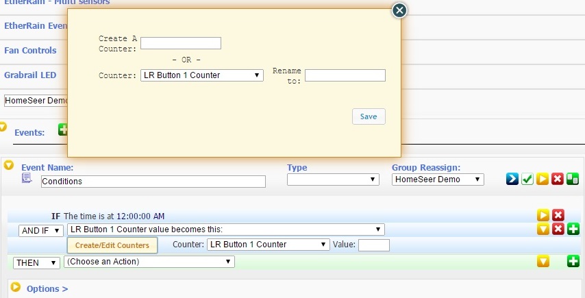

    If you click the same button with a Counter already selected, the dialogue box changes, allowing you to rename the timer, choose another or to create a new counter. As above be very careful cutting from another document and pasting into these windows. If you paste a character that does not belong to the basic ASCII character set, you can corrupt the counter database.
