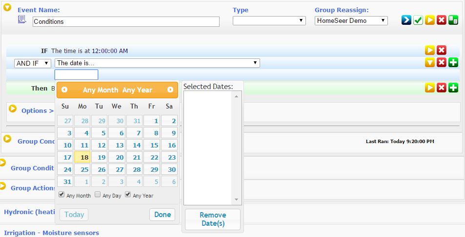

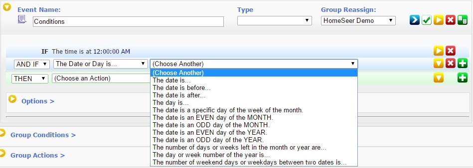

    Now we have a group of conditions based upon the Date or Day

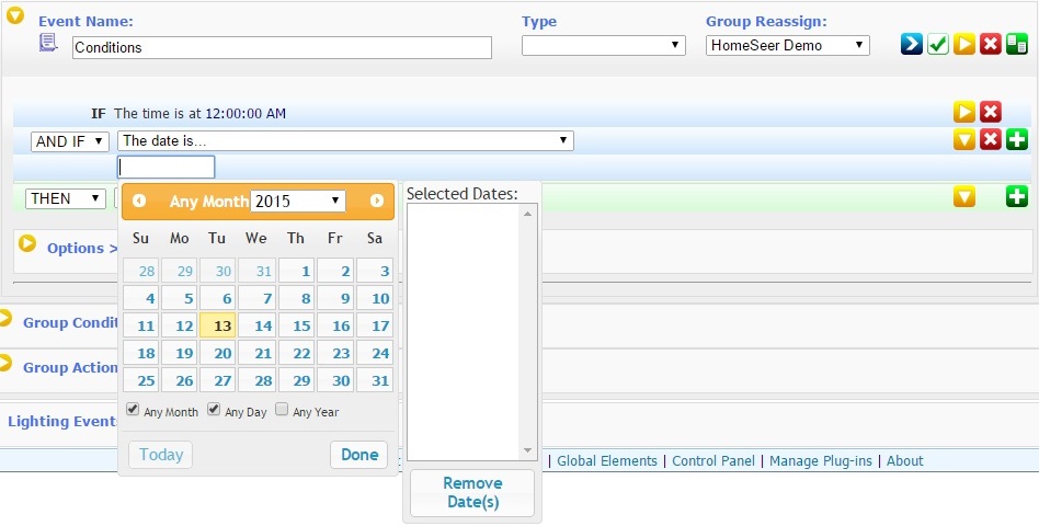

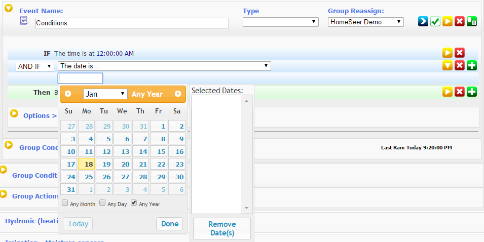

    The popup for date selection is very flexible. It allows you to choose a specific day of the month, month of the year, year or any combination of the three. At the bottom of the date selection popup are three boxes: “Any Month”, “Any Day” and “Any Year”. You MUST select the wildcards of Any Day, Any Month or Any Year before selecting the date. Each time you check one of the wildcard boxes, except for Any Day, the calendar header will change to show the options. For obvious reasons you cannot select all three wildcards, if you do you will get a popup warning. When you click on a date it will populate the Selected Dates column based upon the wildcard selections. If you click on January 15 and the boxes for Any Year and Any Day are selected the date will be entered as 1/D/Y. Similarly if you only have Any Year selected and click on January 15 the date will be entered as 1/15/Y.

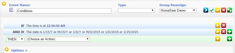

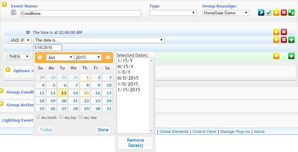

    Here is an example of 5 different selections
    • January 15, Any Year
    • The 15th of Any Month, Any Year
    • January, Any Day, Any Year
    • Any Day, Any Month, 2015
    • Any Day, January, 2015
    • January, 15, 2015
    Selecting any of the dates in the “Selected Dates:” box, then clicking on Remove Dates(s) below, will delete that date from the choices. Also, as you can see in the screenshot below, the selected dates are cumulative. Each date is or’d with the next so that if any one of them is true, the condition is met.
