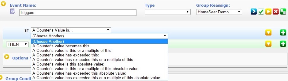

    A Counter’s Value Is…
    This trigger is full of “gotchas”. Fully half of these triggers can result in an event continually triggering unless limited by conditions or options. All four of these:
    • A counter’s value has exceeded this:
    • A counter’s value has exceeded this or a multiple of this:
    • A counter’s value has exceeded this absolute value:
    • A counter’s value has exceeded this or a multiple of this absolute value:
    If your event resets the counter you are not going to have a runaway, otherwise you need to limit it with Conditions or option.
