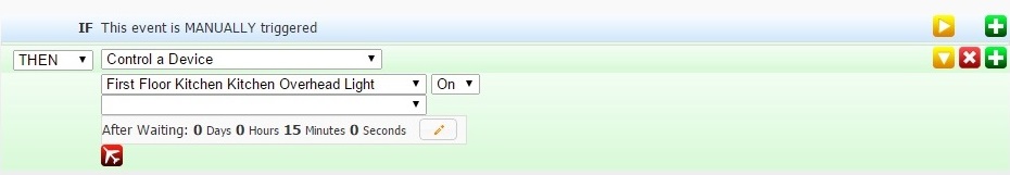

There are two options for actions: "THEN" and "NEVER".
THEN will execute the action if the trigger and condition(s) are true. NEVER is an option to disable a single action for the purposes of troubleshooting or analyzing an event. It provides a means of disabling an action without deleting it. Below is an event with two actions - only the second action will be executed, the first will be skipped.
