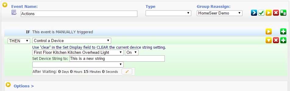

    We'll get to how Delayed Device Actions are handled a little later in this thread. For now we are going to cover Advanced Editing options for this particular action. In the screenshot above you will see the red airplane icon directly under the delay time. If you click on it there will be a new option of "Set Device String to:"
    Since this is the only advanced option for controlling a device, lets go through the steps. We're going to see what this does. The first thing to do is to enter the new String value. Like most of HomeSeer's text editing, you are presented with a text entry popup. Enter the new string value can click on "Submit".

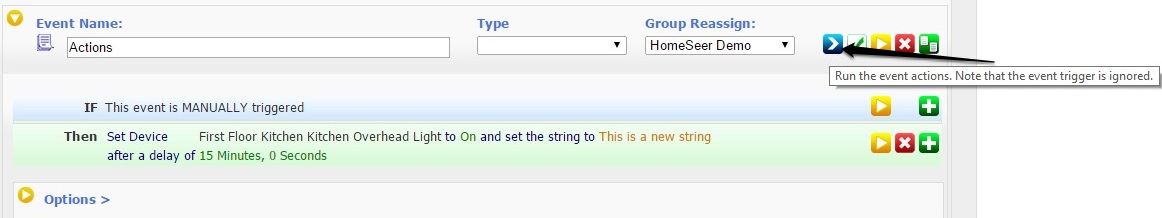

    You can see the Event as it now is - it will set the Value of the Device to ON and set the new string value.

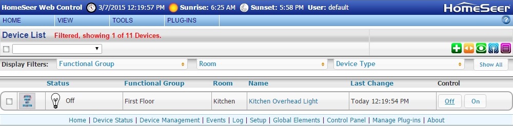

    Here is a screenshot of the device before the event is run.
    We're going to manually run the event by clicking on the "Run Event icon . The event was run manually 12:24:02 PM.

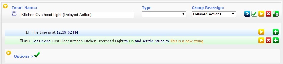

    Since it is a device with a single action and it is a delayed event, nothing actually happens. The Event is not put in a holding queue for 15 minutes, what it does is to automatically create a new event to perform the action 15 minutes later. The primary event has now run in its entirety. The new event is automatically placed in a group named "Delayed Actions" with a trigger of 12:39:02 PM and the same action as the event shown above. This event is also designed to remove itself after triggering. When the event triggers, it will perform the action then delete itself. You can see the green check mark beside options, showing that one or more is selected.
    Here are the Advanced options for the event. We'll cover more about all of the "Advanced Options" later.

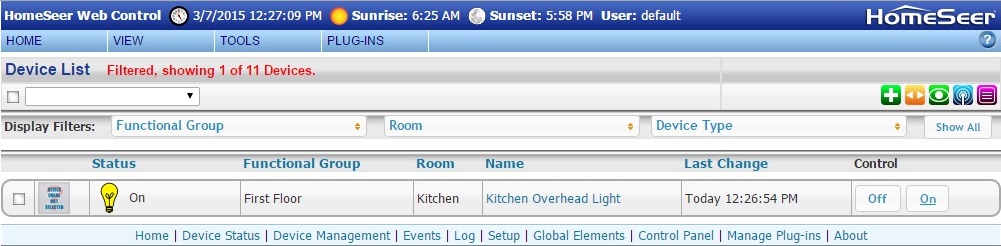

    After the Delayed Action (commonly referred to as a "Delayed Device Action") event runs, the device value, status and string values of the device are set. Below is a screenshot of the device after the action is run. You will notice that the device icon and control buttons show that the device is now ON, but the string now reads "This is a new string" instead of the customary "On".
    If we look at the Advanced tab for this device you can see that the Status and Value have been set to ON, but there is a string value that we have set with the event. If the String value is blank, the Device Manager shows the Value text in its place.
