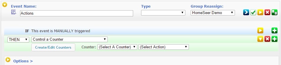

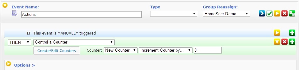

    Control a Counter
    Counter Actions are very similar to Timer Actions. When you choose Control a Counter for an action, you are presented with a second line where you can Create/Edit Counter, pick a counter that you have already created and select the action for the counter.

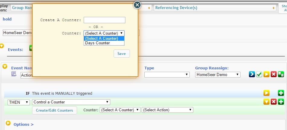

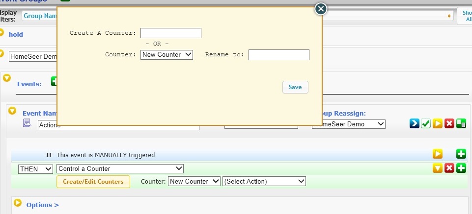

    If you choose Create/Edit Counters you will be presented with a popup where you can create a new counter -OR- select among counters you have already created.

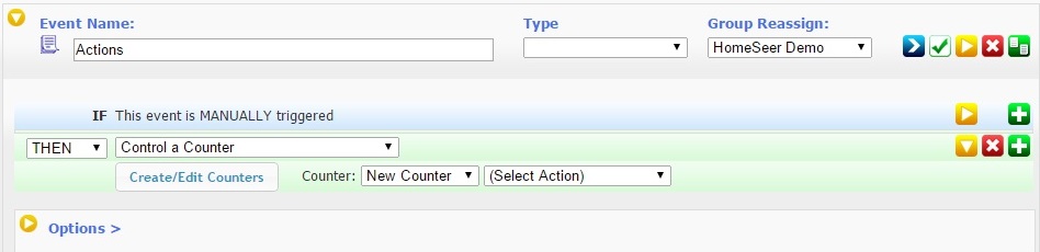

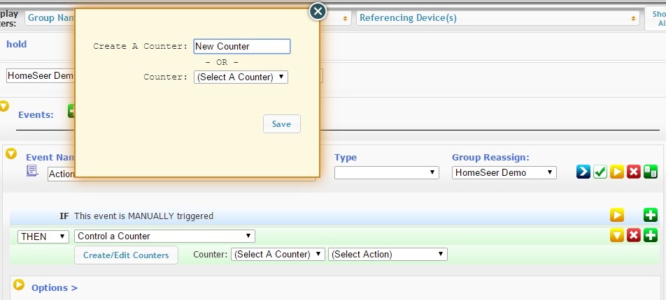

    If you enter a new name in the dialogue it will check that it doesn't already exist and then create a new one.
    When you click "Save" on the dialogue, your new counter is created and will be selected as the counter of choice.
    If you click on Create/Edit Counters with a counter selected, the popup dialogue will offer you the additional option to rename it.

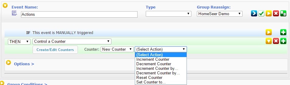

    There are six actions available for controlling a counter. A counter can be incremented or decremented a unit at a time or by a specific number of units.
    • Increment Counter - allows you to increase the counter by a single unit.
    • Decrement Counter - allows you to decrease the counter by a single unit.
    • Increment Counter by... - allows you to increase the counter by a specific number of units.
    • Decrement Counter by... - allows you to decrease the counter by a specific number of units.
    • Reset Counter - will set the counter to 0.
    • Set Counter to... - allows you to set the counter to a specific value.

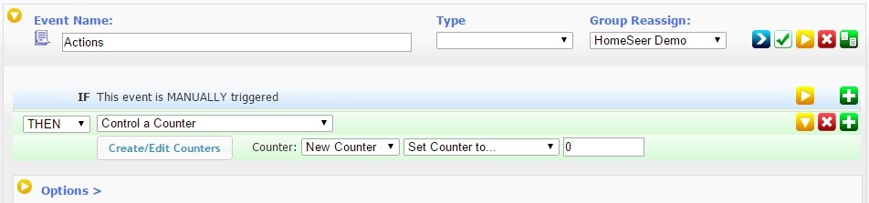

    When you choose to increment or decrement by a specific value -or- you want to set the counter to a specific value, you will be presented with an additional window to enter that value.
