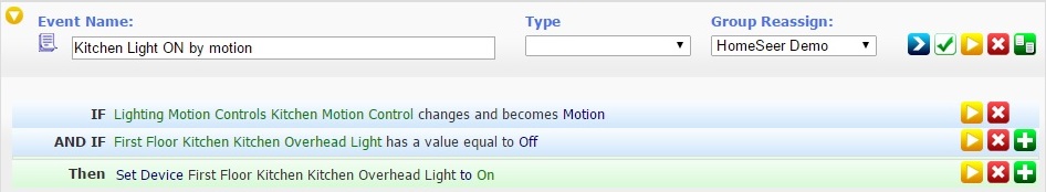

    Event 1
    This event will turn the light on as soon as motion is detected. Using the condition AND IF First Floor Kitchen Kitchen Overhead Light has a value equal to off is just a practice to keep an event from triggering if the light (or other device) is already on.
    If you are using a Z-Wave or other motion detector that has a programmable time out you can set this delay to determine how long the lights stay on after all motion has ceased. Below is an event that will turn the light back off when there is no motion reported. With this event you set the timeout on the motion detector to determine how long after motion ceases before the device sends a no motion report. If you set the timeout to 5 minutes, the lights will go out as soon as you leave the room. If you are continually moving in the room the light will stay on. If you are in the room but are not moving enough to trigger the PIR sensor, the lights will go out at the end of the motion timeout you have programmed.

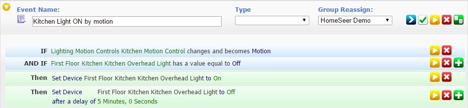

    Event 2
    The above event will not work with wired PIRs or devices that do not allow you to set an motion off delay.
    If you don't want to or cannot set the delay for the lights to turn off in the device itself, another way to have the lights go off after a set period of time is to add a delayed action to turn the lights off in the "On by Motion" event. Below adds a simple delayed action to turn the lights off 5 minutes after they are turned on by trigger.

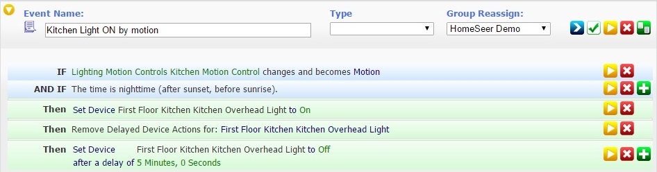

    Event 3
    The problem with the above event is that even if you continue to trigger motion by moving within the range of the sensor, the lights will still turn off 5 minutes after the first motion was detected. They will turn back on if you move around, but only after they first turn off.
    Below is an event that will start the 5 minute timer over each time motion is detected. You will note that the condition of the light being off had to be removed because it would keep this event from working as planned. With that condition the event would not re-trigger until the light was off.
    Event 4
    The above event will work perfectly with wired motion detectors or if you are able to set the timeout on your motion detector to 0. Most Z-Wave devices will set as low as 1 second, but they still are often unable to send a motion detected command for up to a minute. This approach can present two different problems
    1. If you have a long timeout on your motion detector, it becomes problematic. Let's say you have the timeout set for 2 minutes and the off delay at 5 minutes, you must trigger motion again AFTER 2 minutes and BEFORE 5 minutes or the lights will go off with you in the room. If your motion doesn't fall within those narrow constraints the lights may go out while you are in the room.
    2. This event is also problematic if you are continually moving in the room and you have any timeout at all on the motion sensor. It may never go to no motion, which means it will never re-trigger the event, resetting the delayed off timer. The end result is that the lights will go off on you while you are moving around in the room.

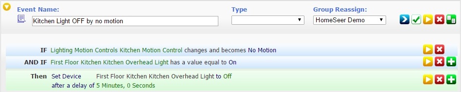

    One solution is to move the OFF control to a second event that will trigger whenever the motion detector sends a no motion command.
    Event 5
    The above simple OFF event will work just fine, except it provides no means of resetting the delayed off action if it is triggered again. Just like the ON event above in Event 4 we can add a an action to cancel the delayed device action each time the event runs, then create a fresh delayed device action for 5 minutes later. You would couple it with a simple ON event triggered by motion. The ON event also removes any Delayed Device actions in case you manually turn the light off and reenter the room before a delayed OFF action has triggered. The two events below are practically universal. They will work regardless of the type of motion detector, with or without delayed off setting. Each event will re-trigger with a change in value of the motion detector. Fresh motion in the room will remove the delayed Off action. Re-triggering the "OFF by Motion" sets a fresh delayed device action to turn the light off.

      If you set "Master Bedroom Ceiling Light" to turn off after 15 minutes, HS will create a one shot event to turn the light off at a time 15 minutes in the future. This event is stored in "Delayed Actions" and will trigger at the time set 15 minutes in the future. If you want to cancel that event and prevent the light from turning off, you use an action "Remove Delayed Device Action for Master Bedroom Ceiling Light". This action will remove all delayed device actions pertaining to that one specific device, if there are any queued in the Delayed Actions" group.
      The reason most of us use it is to restart an OFF timer for a light. If motion turns the light on and a delayed device action will turn it off after 15 minutes, repeated motion in that room will delete the old delayed device action and create a new one 15 minutes later. In effect preventing the light from turning off until there has been no motion for at least 15 minutes.

                              It is one f the many inconsistencies in the event engine. When you choose “Cancel Delayed device Action” it becomes “Remove Delayed device Action” when the Action is completed.
                              The most common method of motion controlled lighting is a single event. Where “Motion” is the motion detector and “ light” is the light, the event is as follows:
                              IF motion changes and becomes motion
                              Then Set device light to On
                              Then Remove Delayed device Action for light
                              Then Set device light to Off after a delay of 5 minutes
                              This will turn the light on when motion is detected and set it to turn off after a delay of 5 minutes. The delay is configured under advanced device options. If you see a red square with an airplane in it under the control a device Action, click on it for advanced options. If the event is triggered again before the 5 minutes is up, the previous Delayed device Action is removed and a new one is created for 5 minutes later. This process will continue as long as there is motion, regardless of how long. As soon as motion ends the light will be turned off 5 minutes later.
                              Removing a Delayed device Action will not error if there is not one.
