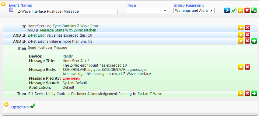

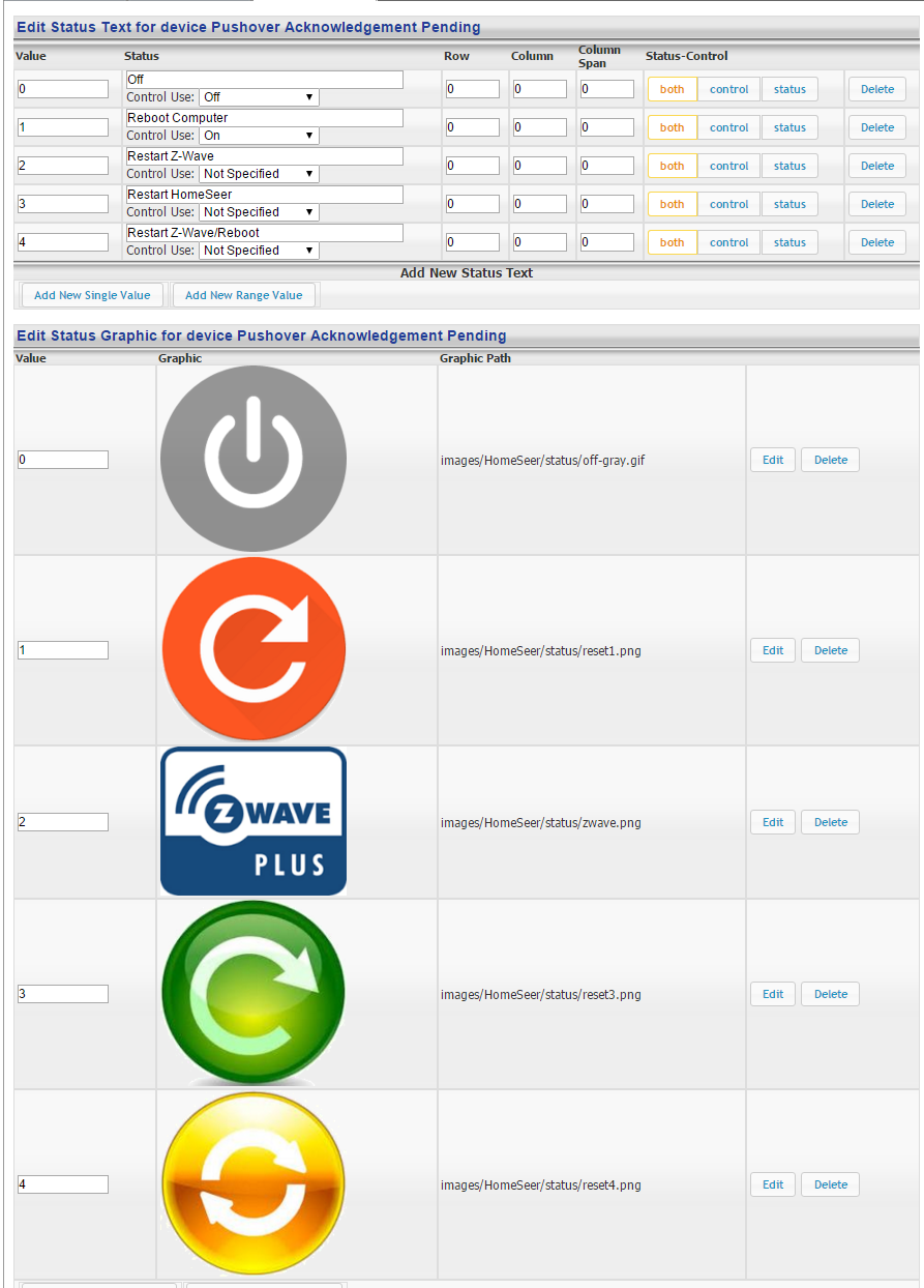

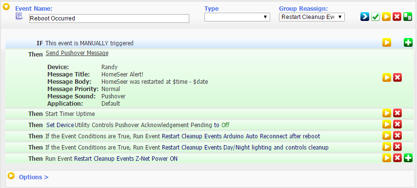

                  Here is how I did it. I set up a framework that would support future expansion. The first thing I did was to create a virtual device that would control what occurs when a pushover acknowledgement is received. I created 4 functions, but it can be expanded in the future. The images used for the device are completely useless, since it is not to be controlled manually, but who knows what the future will bring.

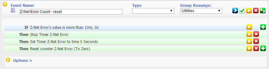

                  Then I created a set of events that would trigger a Pushover Emergency message. First I created a counter and a timer for Z-Net errors, then a set of events that would control the timer and increment the counter. The first increments the counter and makes sure the timer is running whenever there is a specific error logged.
                  The second is a cleanup to reset the timer and counter if the error count was minimal within 10 minutes.
                  The third is an event that sends an Emergency Pushover message and sets up the function that I want to occur when the message is acknowledged.

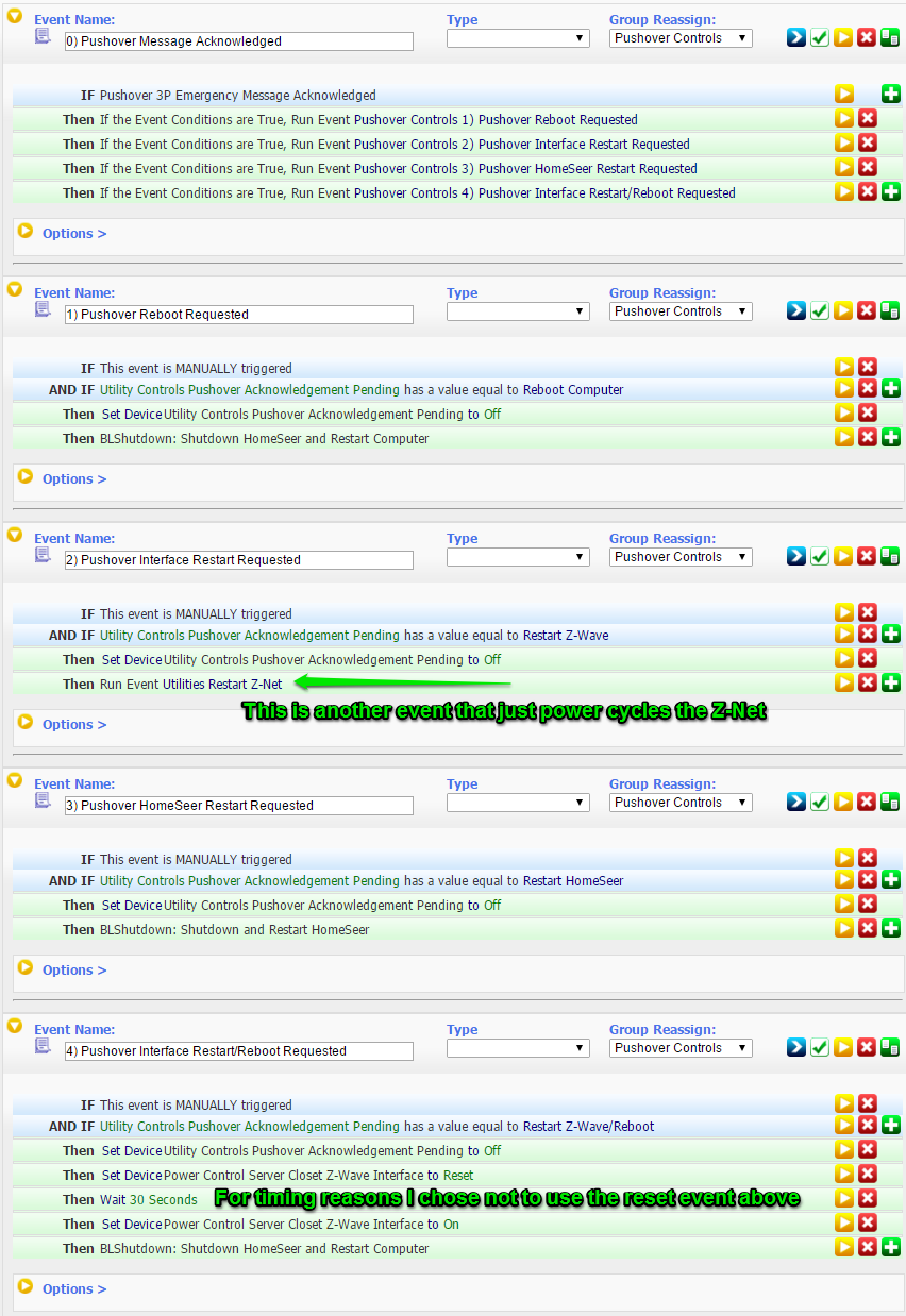

                  Then there is a series of events that are triggered by a Pushover Emergency acknowledgement.
                  • The first event is triggered by the Pushover Emergency message acknowledgement. It then runs 4 events, with each of them running only if the conditions are true
                  • The next 4 are the events, each one is allowed to run only if the virtual device is the correct value

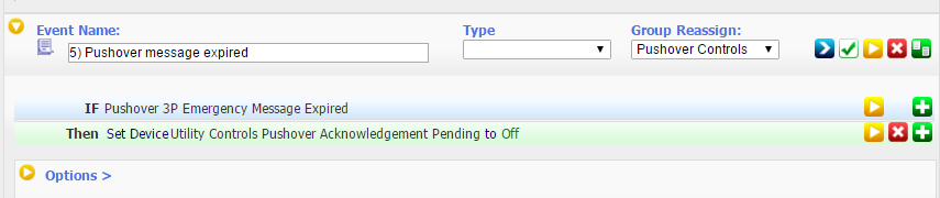

                  • The last event is to clear the Acknowledgement Pending device if the acknowledgement time limit expires
                  Finally I added a reset to the Acknowledgement Pending device any time HomeSeer is started. This event runs whenever HomeSeer starts up.
                  The above is just an example of how I restart the Z-Net interface if there excessive errors within a specific period of time. I built it due to a malfunction that occurred only twice and since I built the events it has not recurred.
                  The framework can be used for every Pushover Emergency message acknowledgement. You just need to set up the function when the message is sent and have a specific event for that function.

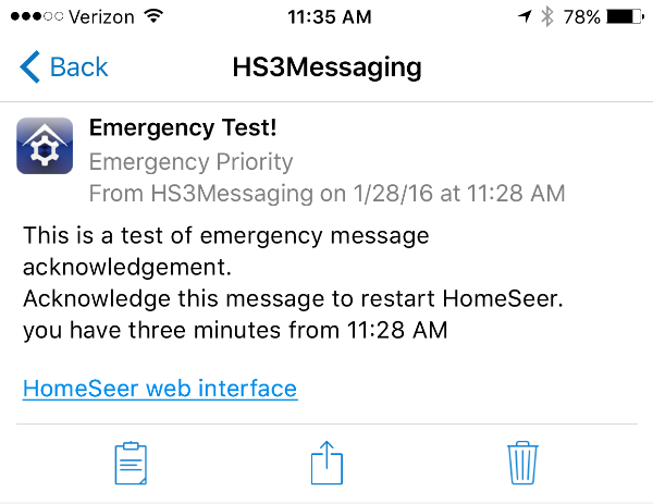

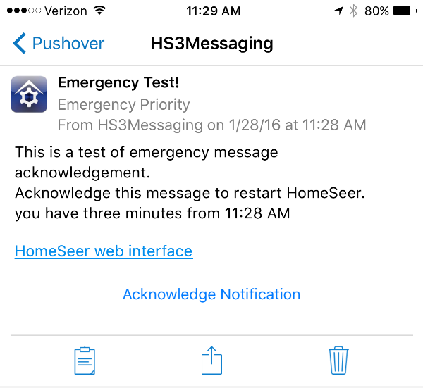

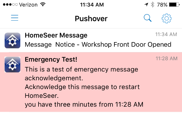

                              Here are some screenshots from the iOS version. You can also include a URL and title in the message (also can now be done with HTML tags in the message), in this case it will take me to my HomeSeer web interface. Tap on Acknowledge Notification to send the acknowledgement back to HS. I accidentally wrote three minutes in this test message, my current expiration is at 5 minutes. It can be set in the plug-in configuration.
                              Emergency messages are a different color and will nag you at a set interval until they expire.
                              Once the expiration time limit has passed, you no longer have the option to acknowledge the message.
