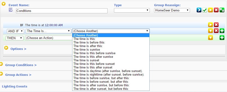

Why not just a trigger of "the time is this before sunset" and then you select the number of hours, minutes ans seconds with the normal popup? There could be three options: the time is this before sunset, the time is this after sunset, the time is this after sunrise and the time is this before sunrise.
I really have no clue but it seems less complicated to me than the graphical interface you demonstrate above.Originally posted by rpradeThere is no rhyme or reason to the anarchy a defective Z-Wave device can cause
and conditions
The problem is that the conditions are rigid- The time is this before sunrise/sunset
- The time is this after sunrise/sunset
Those conditions will only work at an exact time relative to sunrise/sunset.
What I am looking for is the ability to calculate a time based upon hh, mm, ss before or after sunrise/sunset then using it as the value for the standard HS3 conditions- The time is after this
- the time is before this
I would expect the conditions to observe that midnight is the end or beginning of each day just as all other time based conditions.
The schedule idea might work, but like S-F I would rather see it as a configurable condition. It could be a series of 8 choices like the ones HomeSeer offers, where you chose the condition, then the number of minutes.
- The time is before this after sunset
- The time is after this after sunset
- The time is before this before sunset
- The time is after this before sunset
- The time is before this after sunrise
- The time is after this after sunrise
- The time is before this before sunrise
- The time is after this before sunrise
Like I said in the initial post, I'm just tossing it out there - it won't hurt my feelings if you feel it is not something worth devoting the effort to. Because as it is now, I just control a virtual device with standard triggers.
